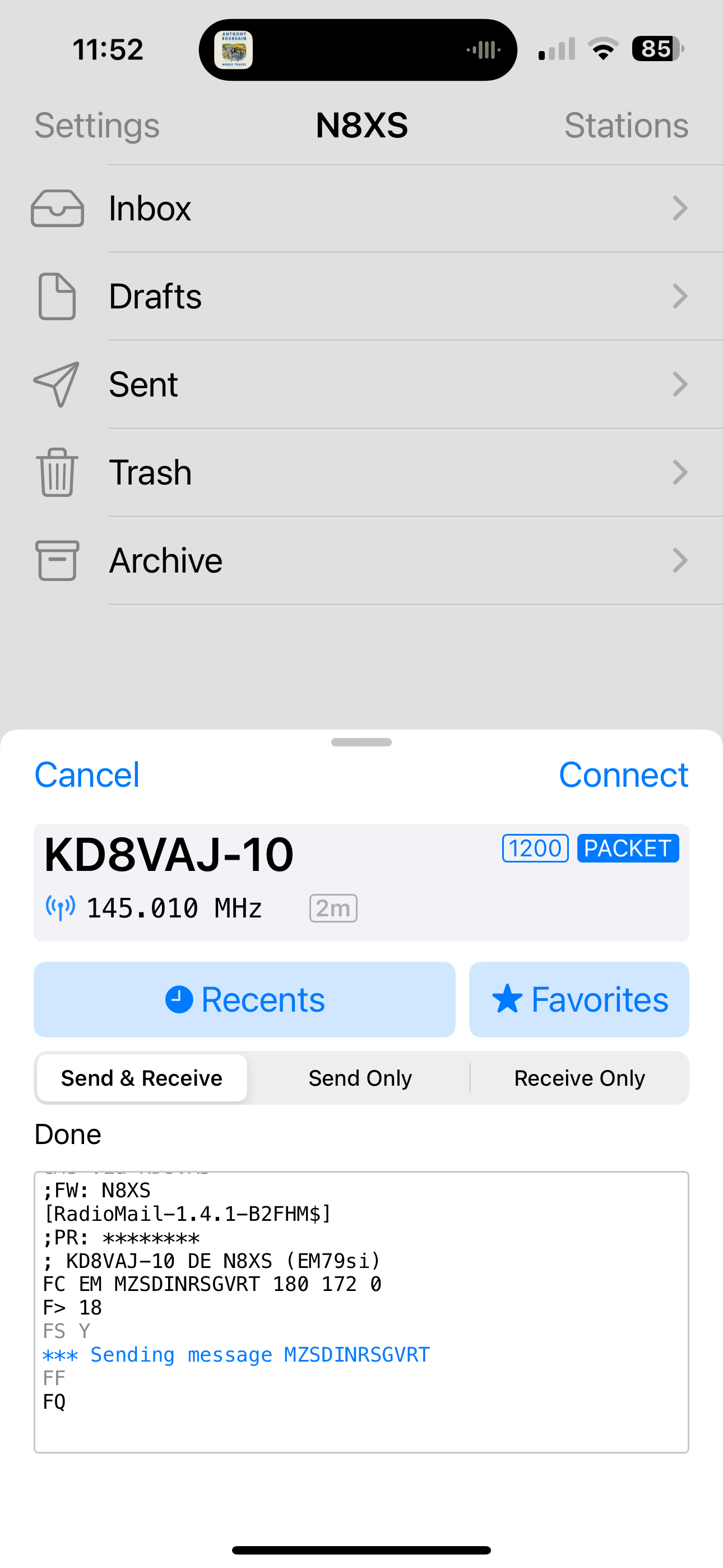

This is the look from the gateway to me:
!image.png|813x173
Here is the session:
!IMG_2851 (2).PNG|1290x2796
And the received email:
!image.png|351x334
