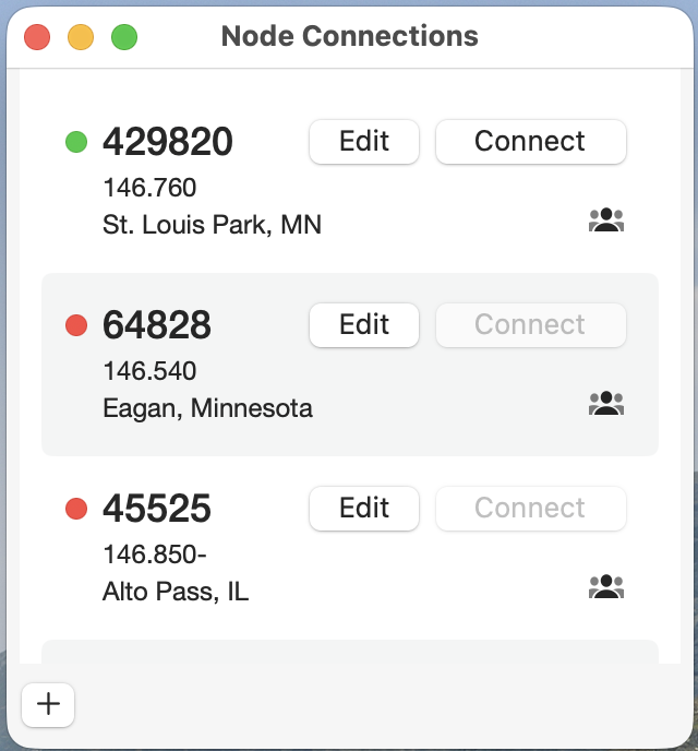

I can’t seem to connect to my node (64828).
I have been able to in the past and am currently able to do so using RepeaterPhone on my iPhone.
I’m also not able to connect to node (45525), but have been able to do so in the past as well. I can also connect to it using RepeaterPhone.
I can connect to node (429820) successfully using Transceive. Here is my current window:
Can anyone help me?
Thanks !!

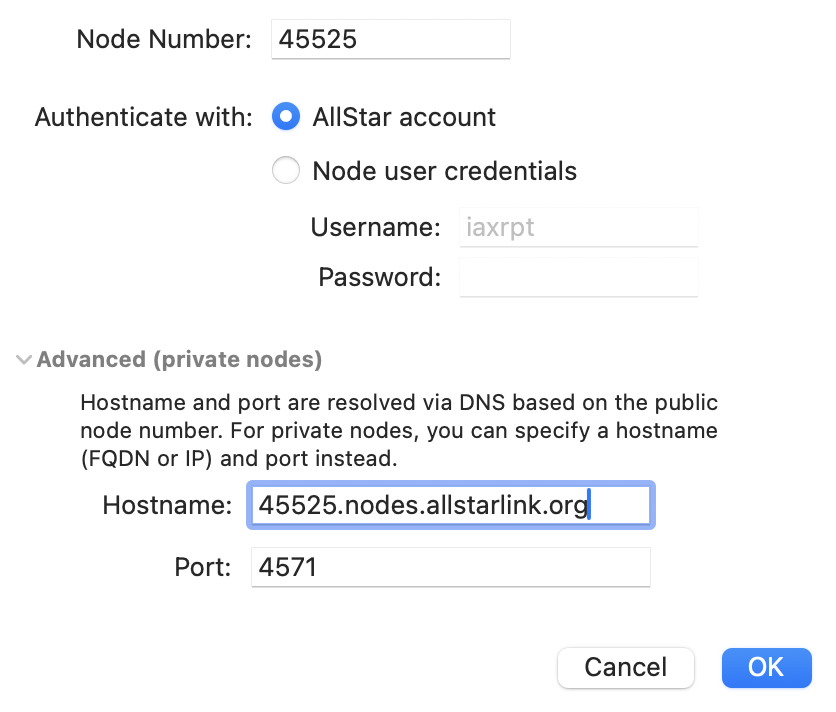

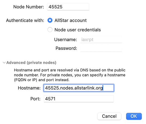

However, it seems that Transceive is not able to reach it for some reason. If you specify manually the host and port, it will connect. Edit the node information like this:

Hi Georges
Thanks for the quick reply. Your suggestion about using the host and port for node 45525 works perfectly.
