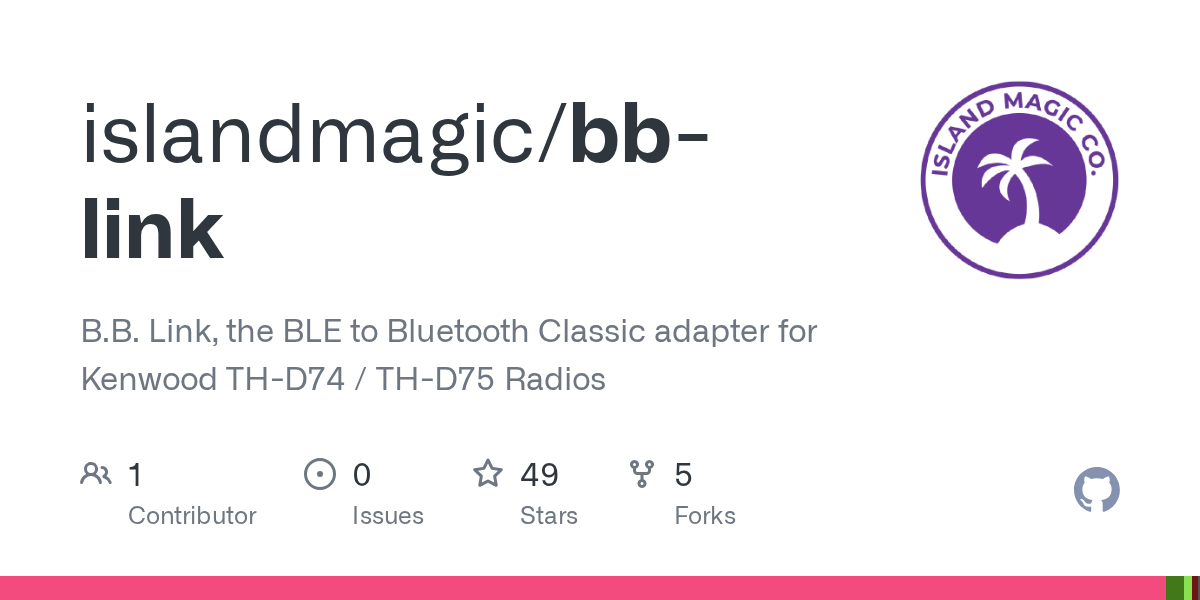

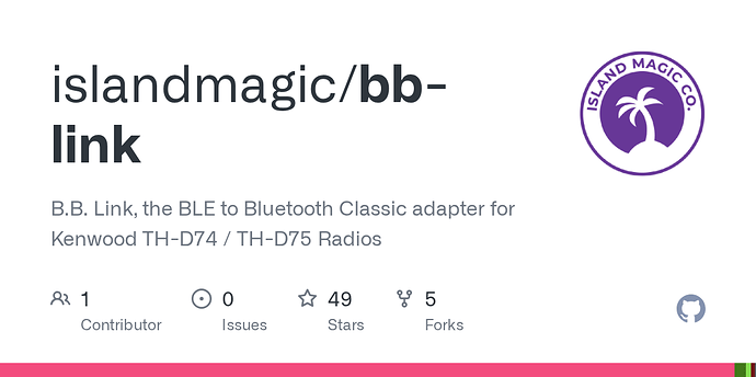

BLE to SPP bridge
B.B. Link, the BLE to Bluetooth Classic adapter for Kenwood TH-D74 / TH-D75 Radios

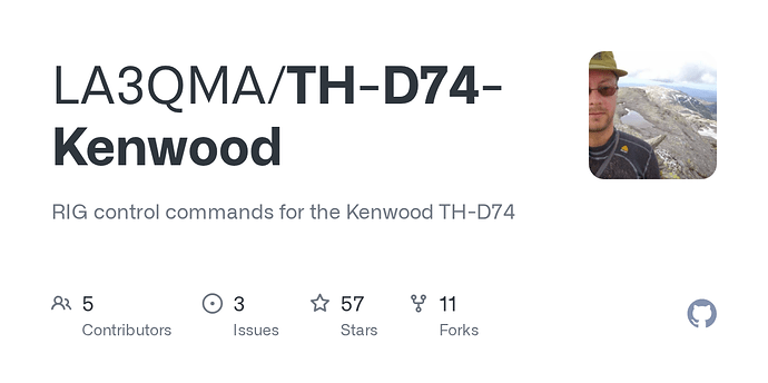

Reversed engineer commands (of course there is no official documentation because radio manufacturers hate you)
RIG control commands for the Kenwood TH-D74
