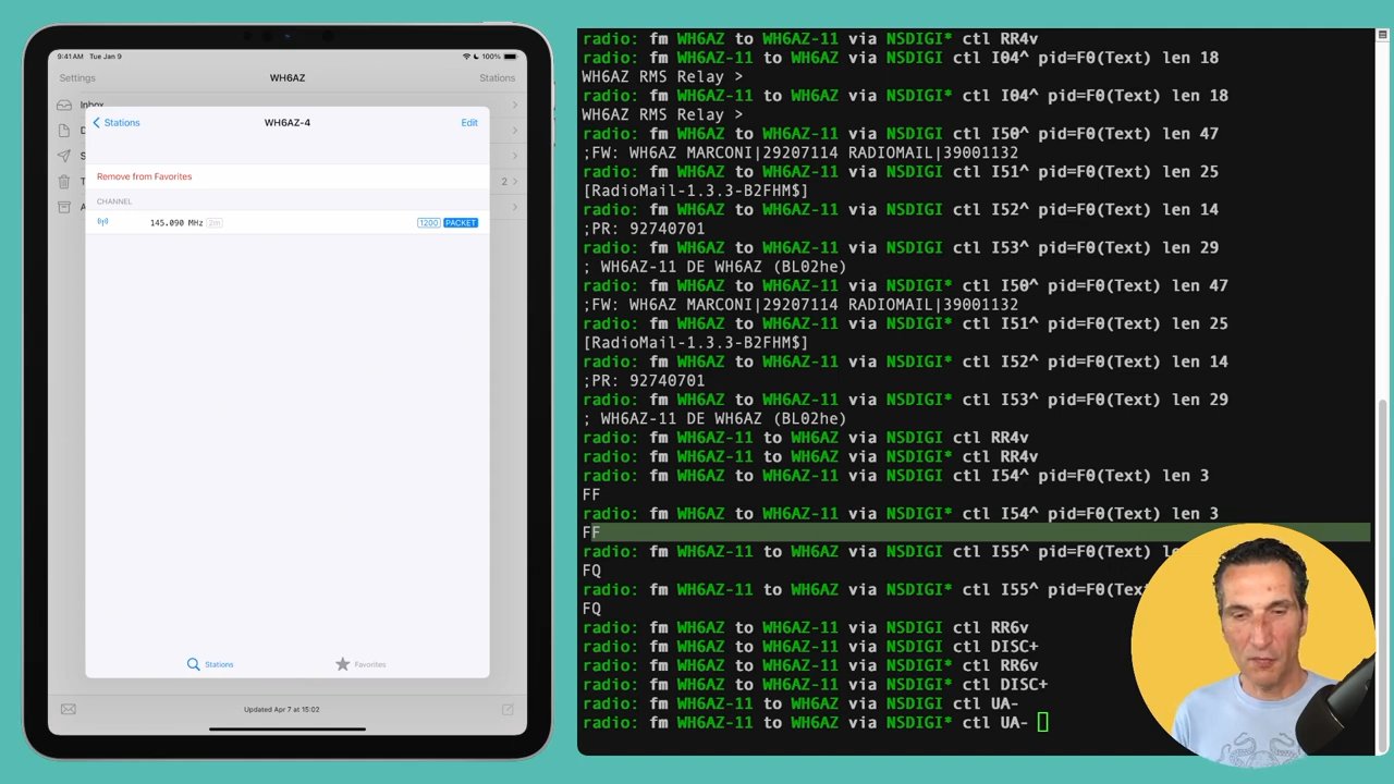

You can learn more about digipeater and scripts in this video:
