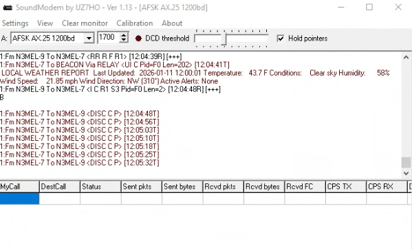

Can you have Packet Commander confirm with the connected node that is has disconnected? What is happening now when you issue the Bye command as soon as the node confirms the Disc command Packet Commander closes, however the node is not receiving the confirmation.
The node continues to sent the DM request to Packet Commander till it times out. See screen shot attached.
