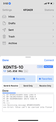

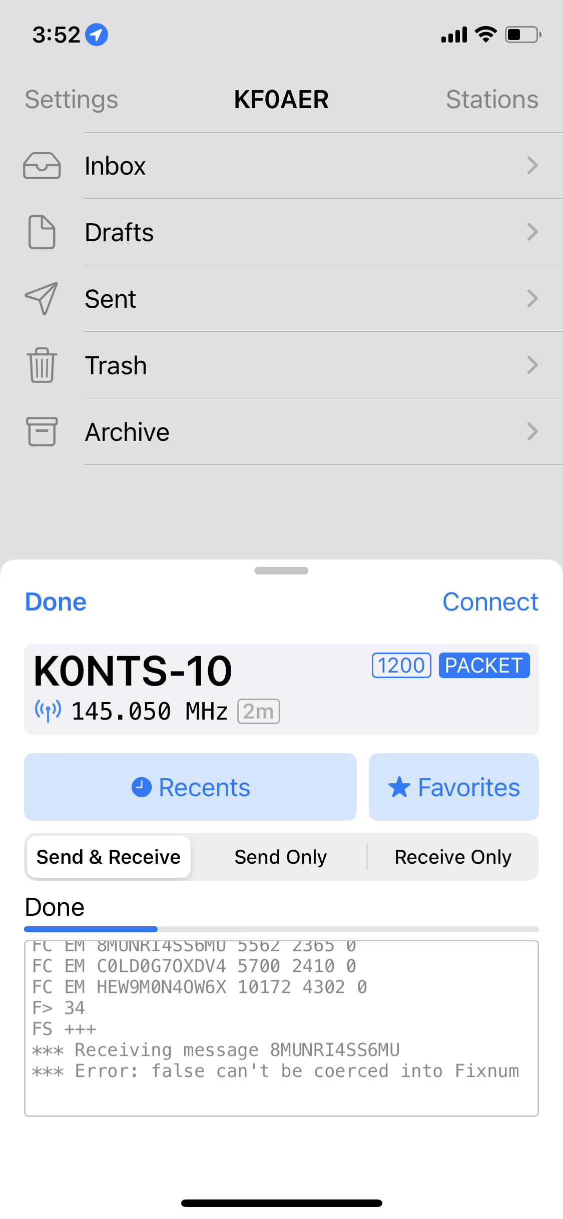

Tom do you participate in similar nets as Glenn? And would the message be a net confirmation as well by any chance?
Your message and Glenn's message are the same 5562 bytes

Yes. The three yesterday were all Winlink Wednesday confirmations or reminders. I haven’t tried to confirm this issue with messages from other nets, like the Thursday Em-Comm net, or with a mixed batch. But I’ll look.
Tom KF0AER
