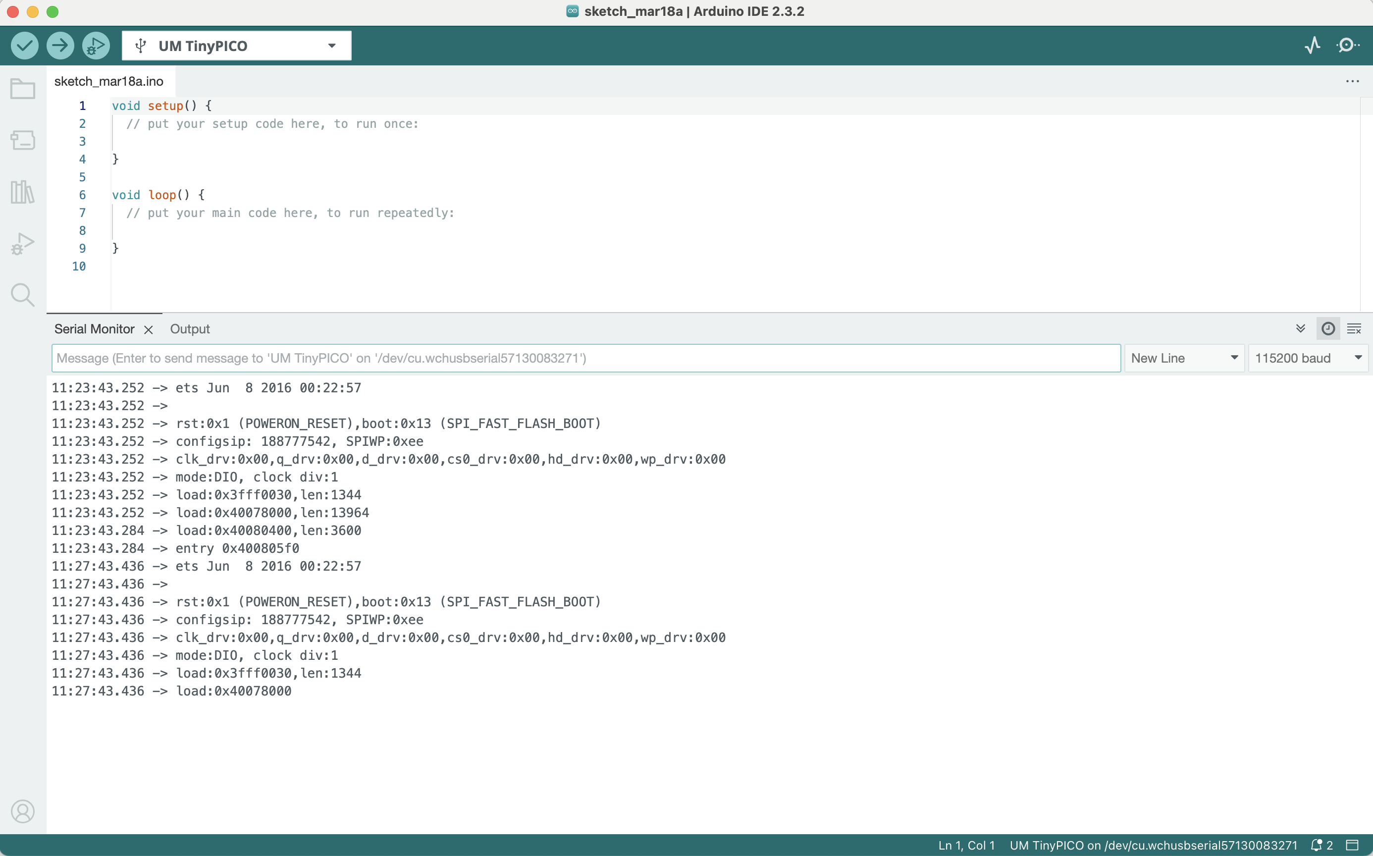

The question marks in the console output means you're not at the correct bit rate for the board. Try to setup the serial console to 115200 bps and hit the reset button on the TinyPICO.

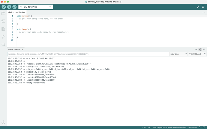

This is what I get with the correct serial bps (I hope) The earlier is before trying to upload the firmware, the otherone after uploading it. After setting the right speed I hit the reset button as you said.
Thanks for your help!
From the look of it, you are flashing an empty sketch. You need to open the source code you want to flash in the IDE. Navigate to where you downloaded the source code, and double click on the .ino file. It will open the project in the IDE and then you can flash it.
Hi Georges,
you nailed it, thanks a lot! I do not know why I missed this step at first but anyway, it works flawless now. Radiomail and the aprs.fi iOS app do find the B.B. Link and communicate as intended with my TH-D75. Great project!
