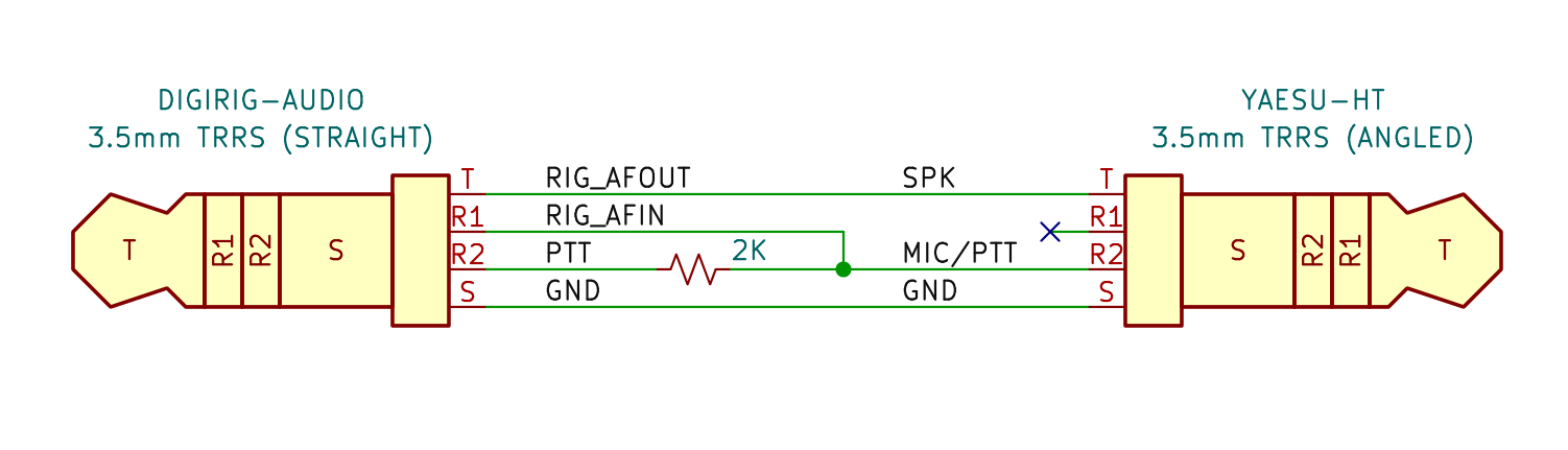

It’s not the digirig mobile. The description on the packaging says mobile cable. I have these cables…
Audio/PTT cable for Yaesu HTs using 3.5mm TRRS connector
Yaesu HT Audio/PTT Cable ( Yaesu HT Audio/PTT Cable – digirig )
digirig.net ( Yaesu HT Audio/PTT Cable – digirig )

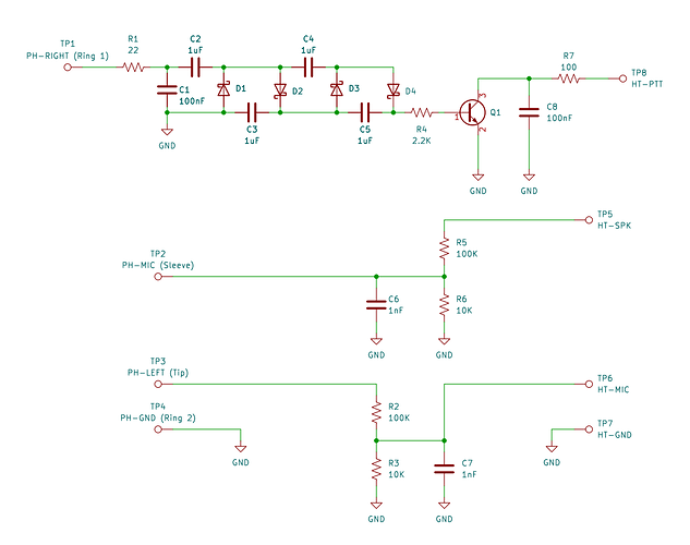

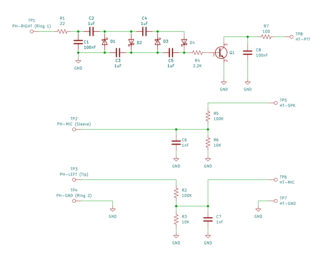

Few issues at play. First, yes make sure the tones are playing and that the lightening to 3.5mm audio jack is working properly.
The issue with the FT-60 is that PTT is wired into mic in. So if you look at schematic and follow the PTT line, you'll see that eventually it is being fed into the mic input. This means that the signal used to trigger the PTT, will bleed into the audio.
To alleviate the effect of this you can select a higher frequency for the tone that triggers PTT. Go to iOS Settings > Apps > RadioMail and change the Internal Packet Modem PTT Tone Frequency to some high like 12kHz. This should be filtered out by the circuit in the radio and not negatively impact the transmission.
Thanks Georges
I have the frequency for the tone set at 12kHz, And I tried other settings.
My electronics knowledge is pretty basic at the moment. So, electronic schematics might as well be Egyptian hieroglyphics.
I’m suspecting the VOX PTT cable.
I get tone from the iPhone/iPad speaker with nothing connected.
I get tone through the headphones when I connect them to the iPhone/iPad through the 3.5 to lightning adapter.
I get no tone when i connect the VOX PTT to the lightning adapter and the headphones to the VOX PTT.
