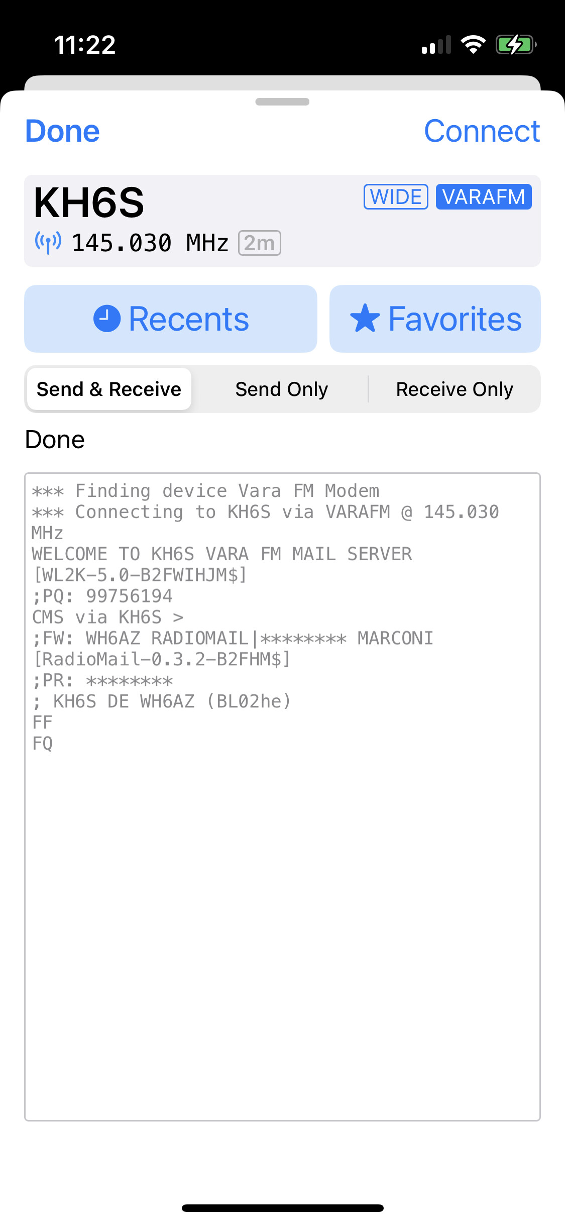

Anyone having issues connecting to VARA FM after the latest version update? It was working before but after the lates release I can no longer connect to my VARA FM modem session running on a computer on my local WiFi network.
I also tried to use it with VARA HF on another computer but it will not connect with that one either although that is the first time I tried on HF so can not say if it was working before this update.

Confirmed 0.3.1 working fine with Vara FM. Most likely a networking problem. Perhaps the computer running Vara FM IP address changed?

IP address was the first thing I checked using ifconfig at command line but it was correct.
I was momentarily confused and was thinking that for RadioMail to work via VARA FM I needed to have a Winlink session running on the computer for it to connect to. Of course VARA FM modem could not reply since it was already busy with the session on the computer.
Once I shut down Winlink on the computer and just opened VARA FM on it’s own it started working again as before.
