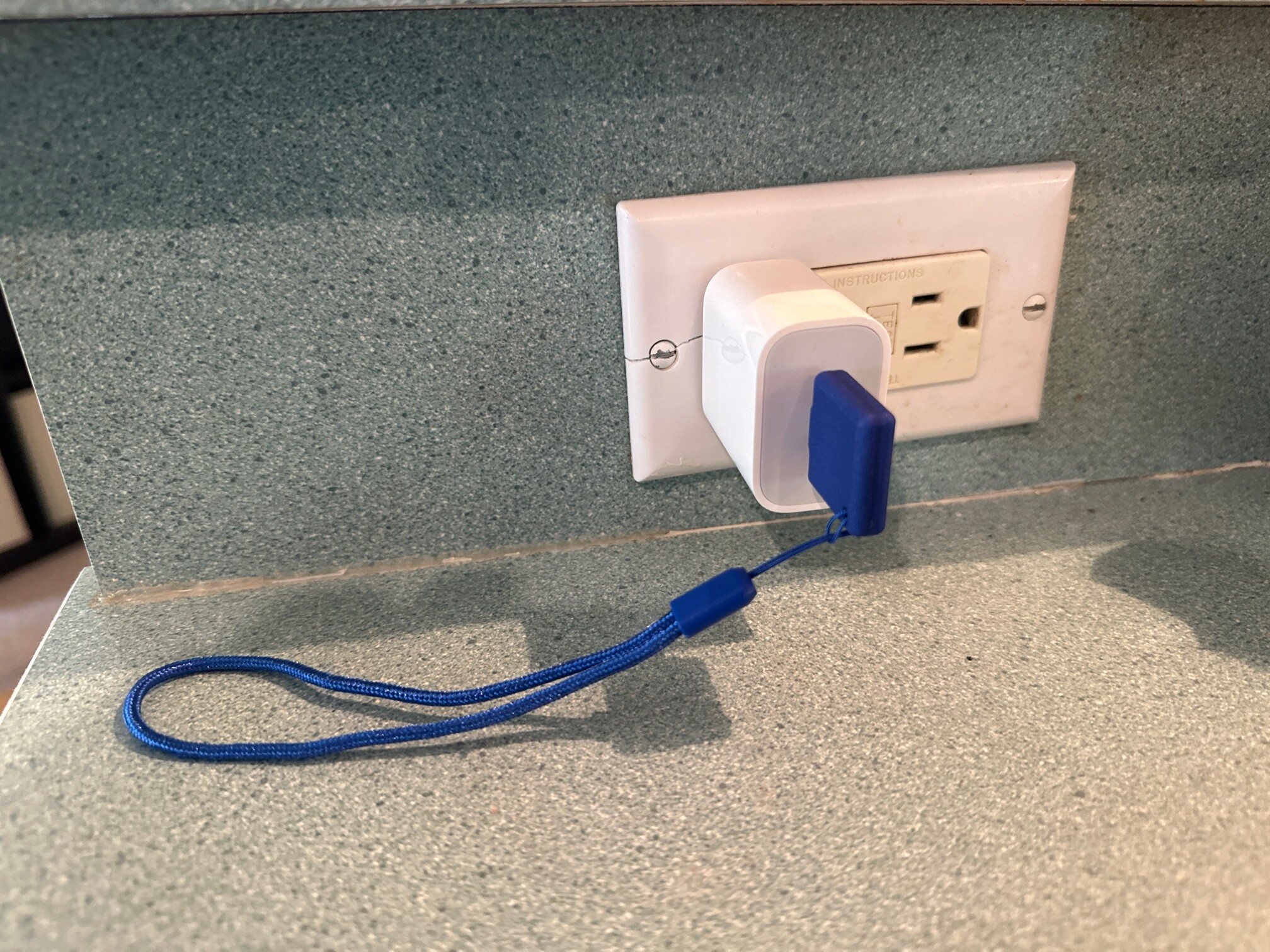

I take that back. Found one thing with USB-C, an Apple charger! Works good. Need to figure out the battery.
73 de N8XS
