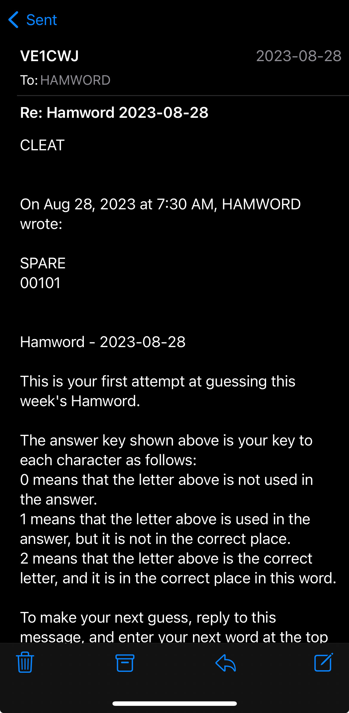

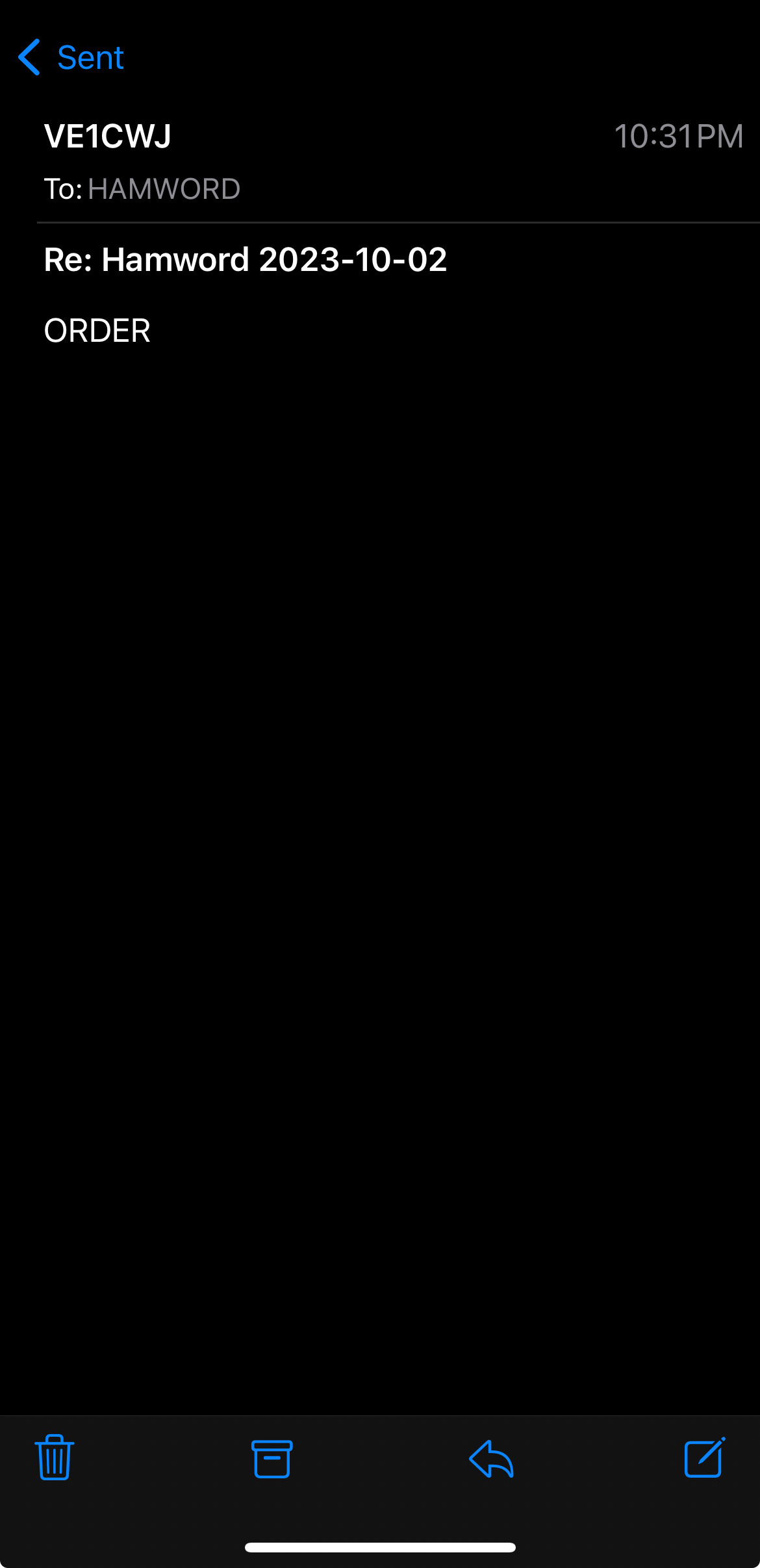

Sometime between 9/19 and 9/25 I noticed a change in the way RadioMail
handles replying to a message.
Previously, the original message was copied into the body of the reply. On
9/25 (presumably after updating to version 1.2.4) I noticed the original
message is no longer copied into the body of the reply.
See screenshots attached from my Sent messages folder for examples.
Was this change intentional or is this a bug? Sometimes it is nice to see
that original message while drafting your reply - like another guess for
Hamword. :o)
