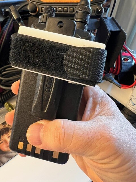

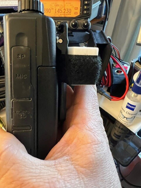

Quick question please. Does the tiny pico charge the battery when plugged into usb?
Yes the TinyPICO has a charge circuit that will charge the battery when plugged into USB.
Works very well. Here I have mine on my ht.
