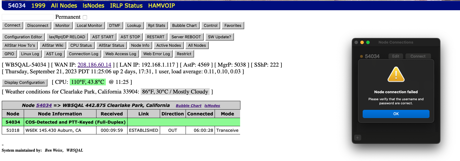

Q: Transceive requires username & password; which set?
No matter which username/password I give Transeive, it always fails to connect.
I’ve tried:
  Node#/pssd assigned by AllStarLink
  root/password of Raspberry Pi
  username/password assigned for Superman
None work.
What gives?

My app now fails to log on and reports error error of in valid password to AllStar. Clearly something is wrong. Seems to have started with Mac OS 14.1.2 (23B92)
Same issue here as you mentioned. I have another node with a previous version of allstarlink working fine with node credentials authentification but with ASL 3 everything fails. Anyone has an update how to get this working?
