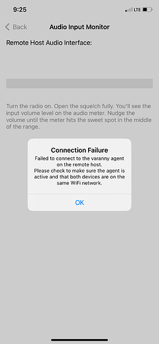

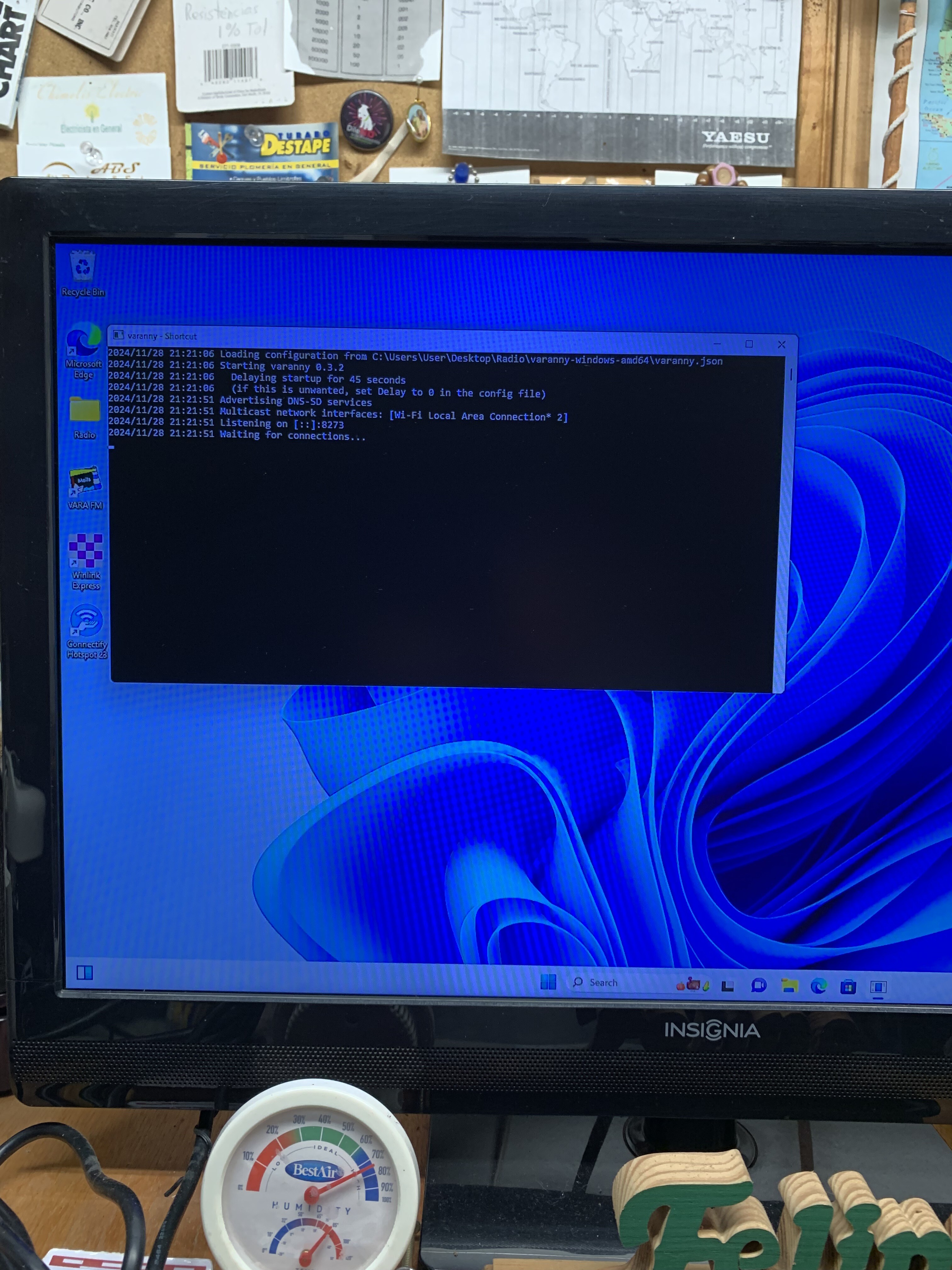

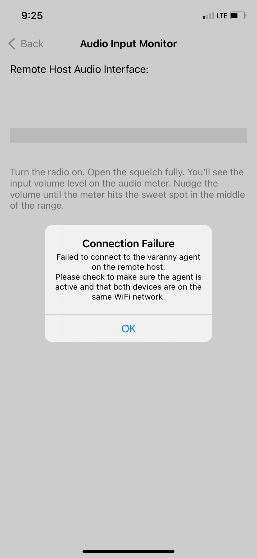

I updated Radio Mail to version 1.4.1(7). For some reason, it stopped connecting to Varrani. Varrani is booting up properly but In Radio Mail I can sometimes see my radios (sometimes not) and I can’t definitly connect with neither radio (I have two in my json file. I tried reinstalling Varrani and tried to find a source for Radio Mail 1.3.5 but did not find any. I just wanted to test and see if this corrected the problem. Please help.
I checked 1.4.1 and it's working fine so I don't believe that's the update that's causing the problem. It's more likely that you're having some sort of network issue that may prevent your device from connecting to varanny. I'd recommend going thru the troubleshooting steps described below to determine where the issue may come from:
https://github.com/islandmagic/varanny?tab=readme-ov-file#troubleshooting
