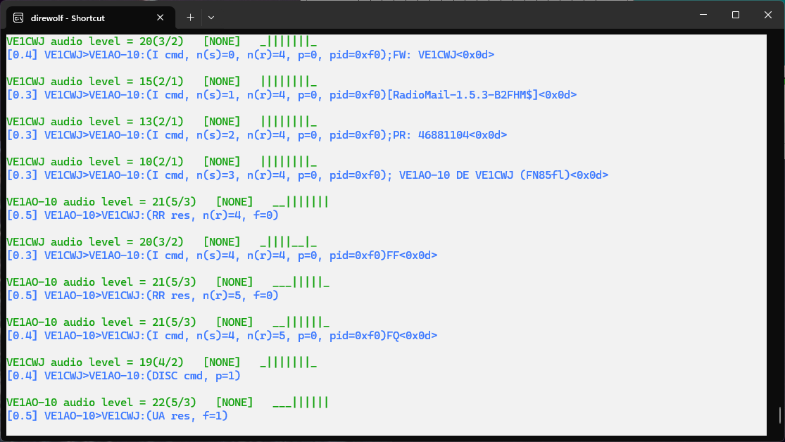

Tonight I dug into it a bit further using both RadioMail 1.6.0 on my iPhone and RadioMail 1.5.3 on my iPad to make a packet connection using the same hardware with both (Mobilinkd TNC4 & Yaesu FTM-400D). I had no issues with 1.5.3 on my iPad and no PTT hang on the final packet. With 1.6.0 I can reproduce this with every connection.

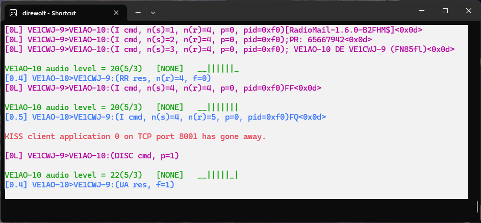

I am attaching 2 screenshots of a Direwolf instance that was monitoring the connection from both devices. With RadioMail 1.6.0, the “DISC cmd” packet doesn’t appear to be sent - the last packet from RadioMail is the “FF” message. Interestingly, RadioMail advances to the screen you would expect to see when the connection is complete (with the Done button). Presumably the PTT hangs when the “DISC cmd” packet would be sent. The gateway times out sending “DISC cmd” messages at this point.

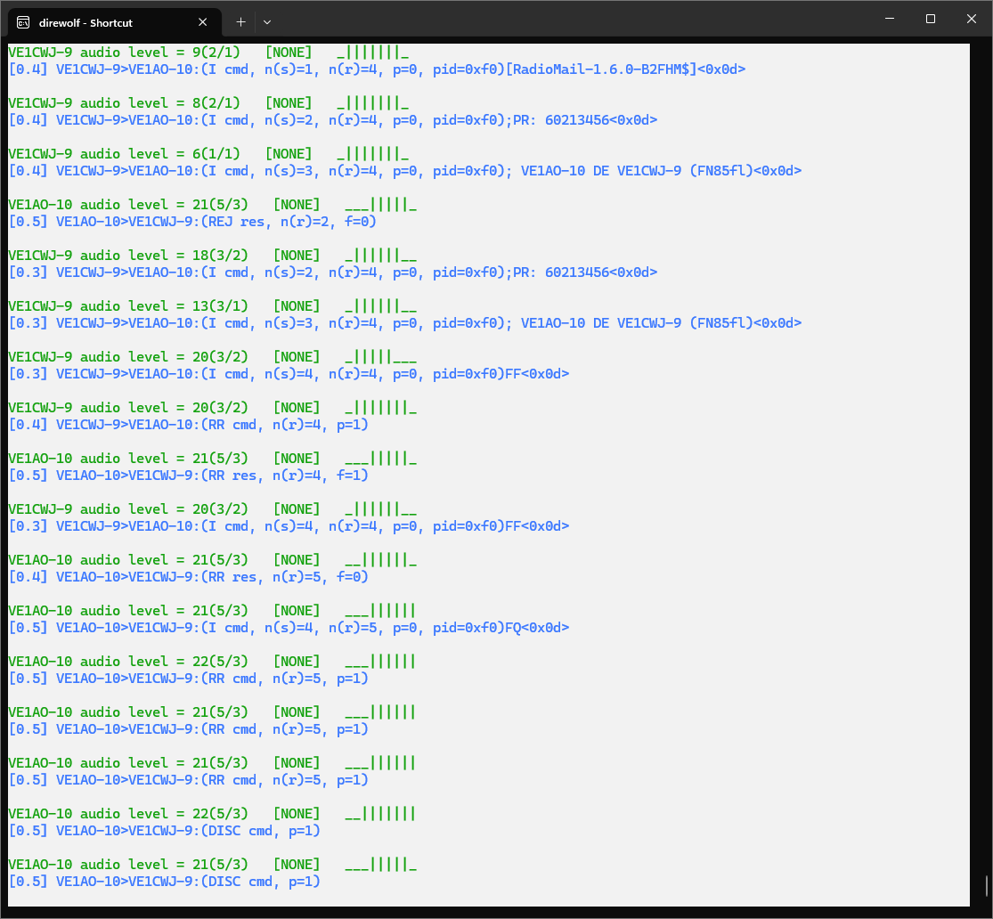

I tried a packet connection with RadioMail 1.6.0 and a different hardware setup - Direwolf/DIY cm108 USB soundcard/Kenwood TM-V71A. This connection worked fine, no PTT hang and the “DISC cmd” is sent (screenshot attached).
It seems like the combination of RadioMail 1.6.0 and the Mobilinkd TNC is where the issue is occurring.

Thanks for the troubleshooting and confirming the behavior. I’m able to reproduce the problem.
The Mobilinkd seems stuck in a that state, even though RadioMail has disconnected from bluetooth. You can quit the app or unplug the audio cable and it still in PTT until you power cycle the Mobilinkd. Weird.
