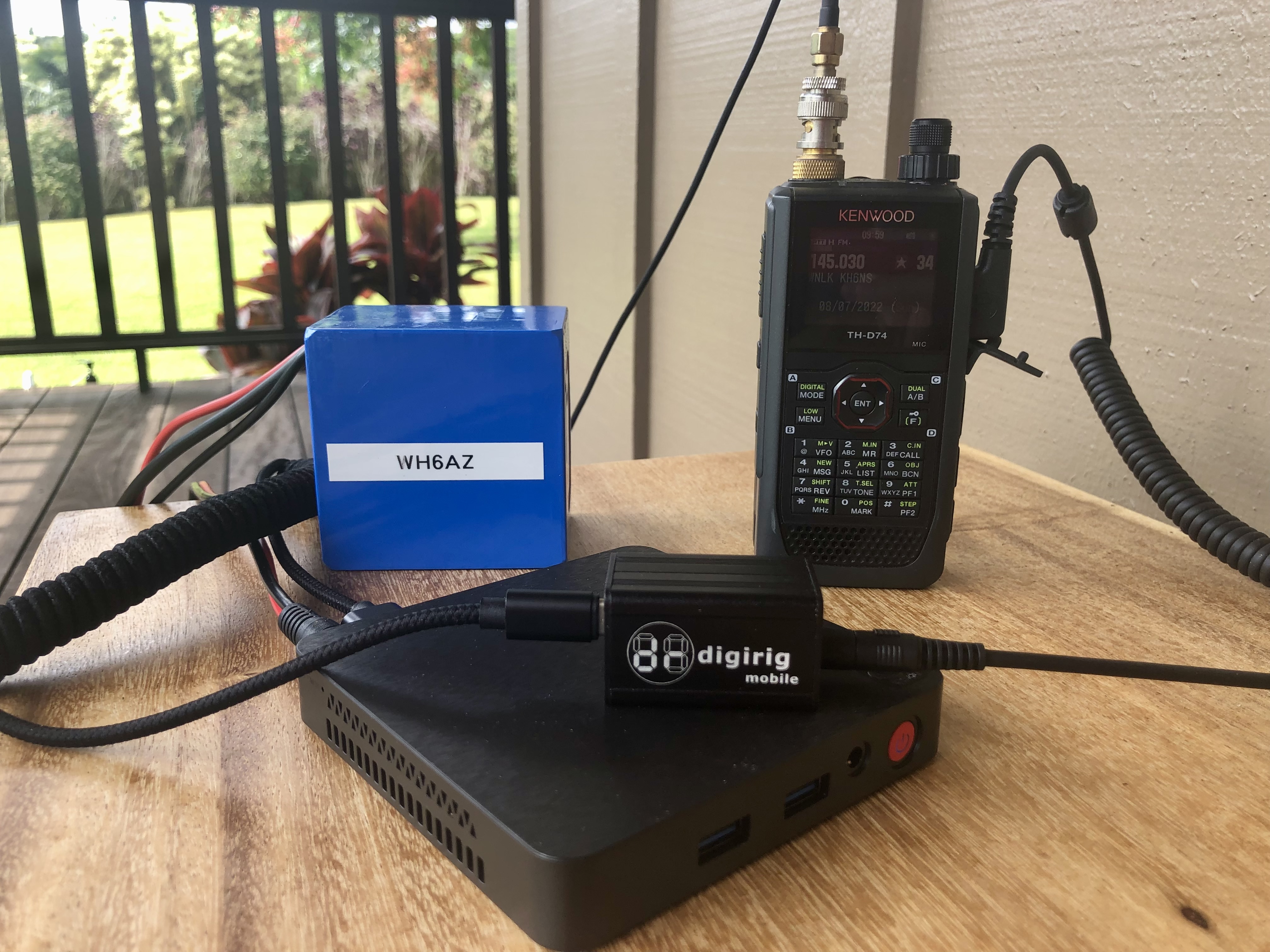

WRT Vara, yes unfortunately Vara is closed source and more importantly a proprietary protocol (which seems like a weird choice to deploy so widely for ham radio use, but I digress). Currently the only path I can see for enabling Vara interoperability is for some enterprising DSP expert to reverse engineer the protocol so independent implementations can be created. Until then, a tiny PC or RPI to run the Vara modem as a headless server is the best that can be done. Below is a picture of my setup using a tiny Beelink T4 (runs on 12V) running Vara modem on Linux. It pains me that an extra computer is required but it still delivers a fairly compact system. The benefit is that you don't need extra keyboard and screen. You can can compose emails on your phone ahead of time, and then walk up to your station and send/receive.

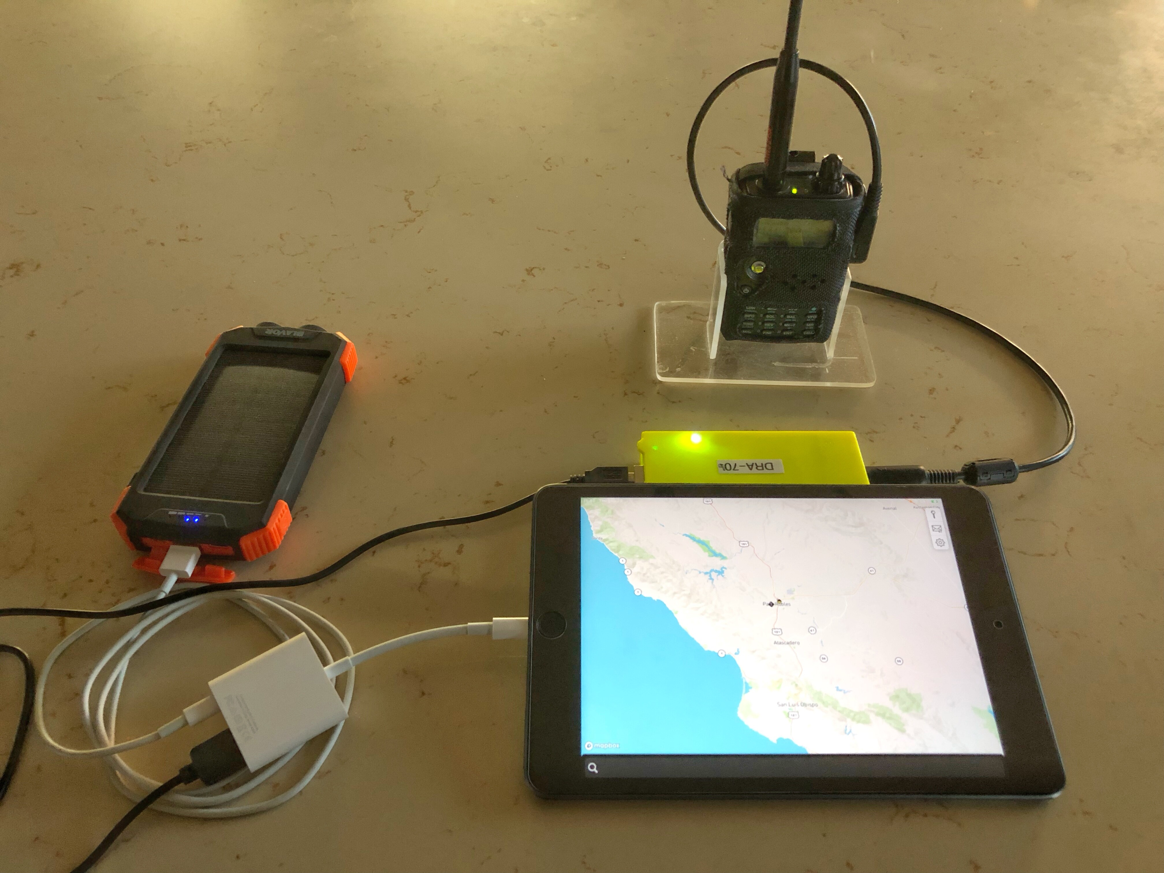

OK, this is ugly, but it does work:
iPad with Apple "Camera" adapter (really just lightning to USB)
Masters Communications DRA-70 sound card interface with VOX enabled
TH-F6A
Using one of the APRS apps that has a built-in audio modem
Too many wires, the iPad does not have enough power for the DRA, so you have to plug in a charging cable too. But hey, it does work....
-Scott, NS7C

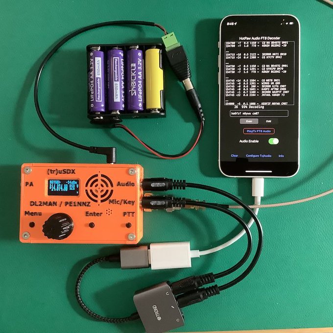

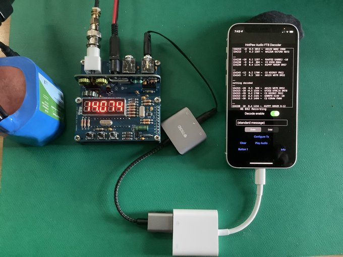

by Ron, N6YWU "The FT8 decoder.....‎FT8 Decoder on the App Store. ..allows decoding FT8 8FSK modulated signals contained in externally provided audio or sound from an SSB radio or SDR. The app can also generate standard FT8 message audio, so can be used to experiment with sending and receiving FT8 encoded and modulated audio. The app does NOT perform Auto-sequencing or encode long hashed callsigns. Enabling VOX works for Tx. "
There is no CAT control support, so you have to tune the radio to the desired FT8 band, and use your transceiver's VOX mode to transmit. The wired connection method depends on your particular radio. The iPhone and iPad TRRS jacks requires certain impedances and levels. Reports are that some of the Elecraft rigs will work with just a splitter and audio cables. I use a Lightning-to-USB adapter plus a mini USB "soundcard" with my small QRP transceivers (QRPGuys Digital FSK III kit and (tr)uSDX units), but plan to build an audio cable with an small impedance plus level matching network to use with Apple's tiny Lightning-to-TRSS-audio adapter.
