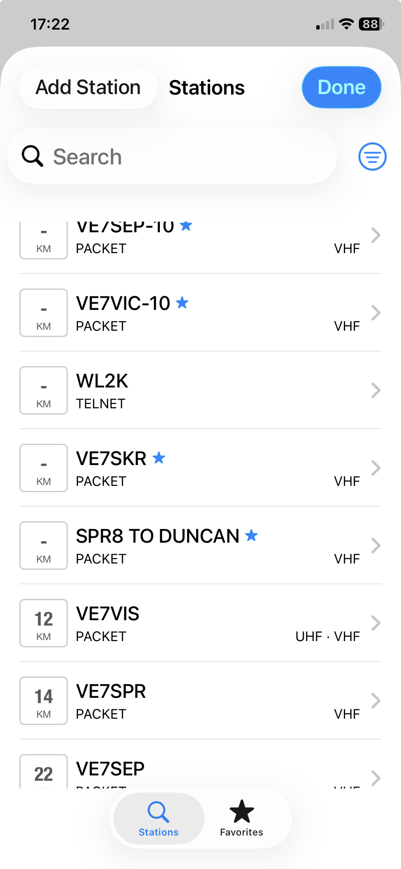

Can you post a screenshot?
Here is a screenshot, showing distances for stations 12 kms away but not for stations closer than under 12 kms from my station/position.
Bernard
VA7BLR
[image/png:Screenshot 2026-08-31 at 17.22.03.png]
of the 5 stations showing:
WL2K - is telnet so distance does not apply
SPR8 TO DUNCAN - this looks like a custom station you added with perhaps a script or at least a custom name. there is no distance used for user entered stations
Could the 3 other station be stations you entered as well?
Thank you, Georges.
Yes, I added SPR8 TO DUNCAN to use with scripts.
By the way, I haven’t been able to connect to -10 stations via scripts. Is it because it takes too long?
No, the other 3 stations were not added.
Yesterday, the closest station shown was 12 kms away. Today the distance for that station is not shown and the closest one is 25 kms away. In addition, appearing above the 25 kms station in the list is KD5GKH - 2037 kms away!
Looks like there might be some computed distance that got corrupted.

My Station Directory was on Automatic Refresh. I turned that off and clicked Refresh Now. Waited until it was complete.
I am still not getting distances for all the stations.
The closest one is 12 kms; the next one is 25 kms. There are some stations I know that are closer and don’t show distance, and some that are between 12 and 25 kms and don’t show distance either.
