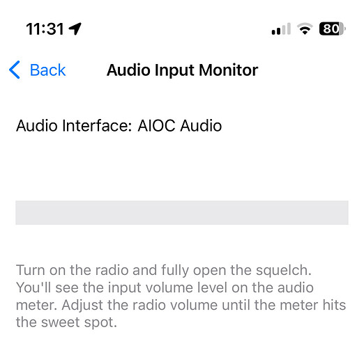

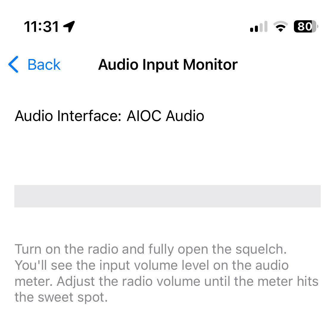

I’d like to use an AIOC with RadioMail. It detects the audio device when connected to my iPhone, though there’s no activity when I open the squelch on my HT. The output test doesn’t appear to work either, via the serial-port-based PTT or VOX.

The audio input should work as the device present itself as an audio interface. Perhaps something needs to be adjusted regarding the sample rate.
However the biggest problem is going to be on the PTT side. iOS does not allow access to HID or Serial control to activate PTT. The only way PTT is controlled right now on device like the Digirig Mobile is by using the left audio channel as a control channel.
There is mention of “Virtual-PTT: This feature allows your AIOC to be configured to automatically assert the PTT line when it receives TX data from your PC.” which might work around this problem in future versions.
I’ll order one and see where they are at with that development.
