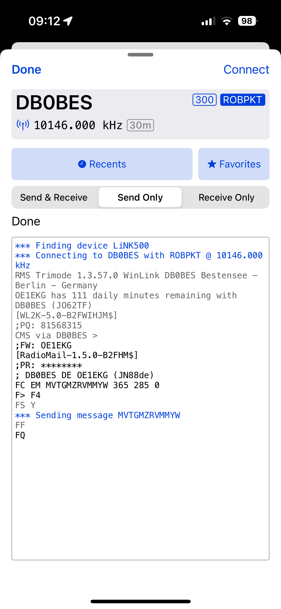

Good morning,
successful test this morning. See protocol. What I cannot test is to set frequency on my KX3 cause there are no setting options for this transceiver.
What I miss in the stations list is YT7MPB like Winlink Express list shows.
Thank for the great work Georges.
73 Erwin, OE1EKG
Thanks for testing again. Frequency control is not available. I don't know that is something that the TNC would support.
I see YT7MPB in the directory. Maybe you need to refresh: RadioMail > Settings > Directory and tap "Refresh Now"
