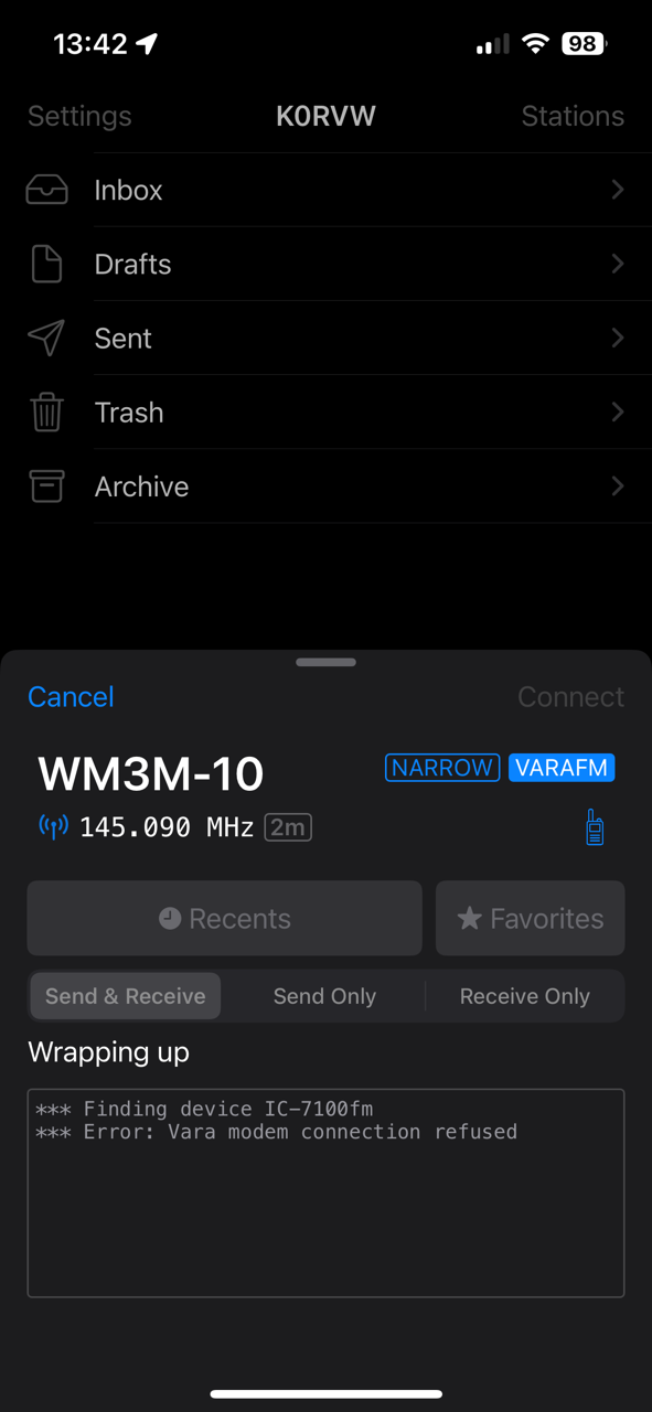

1 - When I first connect to either modem, it takes a while to launch the modem in WINE and it seems that Varanny and/or RadioMail times out. I get an error in RadioMail saying the connection to the modem was refused. (See photo below.) But, if I connect AGAIN, I get through. Well, I get an error dialog saying another VARA * is running, but I clock OK and move on, and the connection goes through. Note: Rig control is correctly changing the rig frequency in both cases, FWIW, and it is changing the frequency back when it’s finished. Nice.

Just released a new version of varanny. I've added some code to wait for the VARA modem to bind to its port before returning to the client. This should help in preventing RadioMail trying to connect too soon to VARA and fail.
https://github.com/islandmagic/varanny/releases/tag/0.3.2
(FWIW, I’ve been compiling from src, but that’s me.)
The update did the trick, thank you! Launch is clean and RadioMail finds the modem just fine now.
