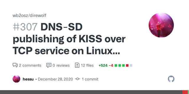

DNS-SD was merged in
https://github.com/wb2osz/direwolf/pull/307
DNS-SD publishing of KISS over TCP service on Linux and Mac by hessu · Pull Request #307 · wb2osz/direwolf
github.com
You may need to recompile from source.
Ah, apparently it has not been added to the Windows distro.

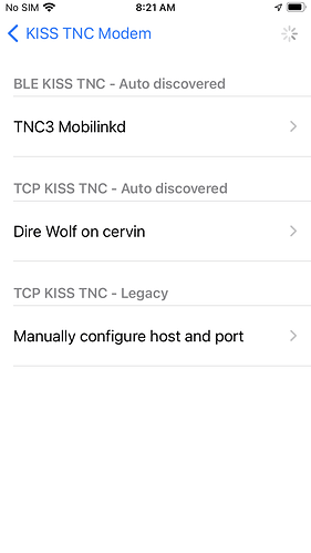

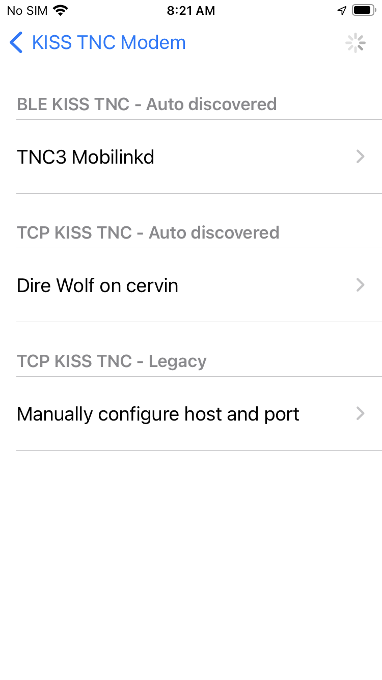

Thanks for all the good feedback here. The desire to deliver a more "turn key" experience is what led to focus on zero-conf solution first. If printer can do it, it should set the bar for usability :slight_smile:
This being said, I did not realize Dire Wolf addition of dns-sd was not available for Windows yet. I found a way to add manual option that's fits in the discovery model. Look for it in upcoming update in the next few days.
