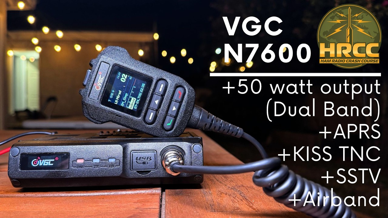

Glad you got it working but most likely unrelated to the new firmware. Josh demonstrated pairing with N7600 two months ago.
Some things to note:
Pairing behavior
The pairing process can be flaky: the radio expects the host to write data before pairing completes, which triggers the iOS “Pair with device” dialog (see video). Because of how RadioMail currently discovers BLE devices, the radio’s name can sometimes be truncated. Packet Commander already uses an improved discovery approach that fixes this; that code will be back-ported to RadioMail in a future update.
N7600 frequency control (workaround)
The N7600 is not yet whitelisted as a device that supports frequency control (as noted by the lack of blue HT icon on RadioMail’s connect screen). Now that BLE support for the N7600 has been confirmed, it will be added to the whitelist in a future release. In the meantime, set the frequency on the radio itself before starting a session.
