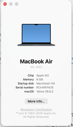

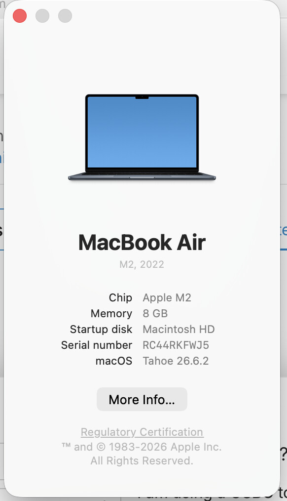

I am using a USBC to USBC cable that is working on a windows PC with VARA FM and Winlink. I have updated the AOIC to the latest 1.41 firmware.
The same cable and AOIC is working on windows but on Mac I am not seeing the device looking for it in the RadioMail on the Mac
